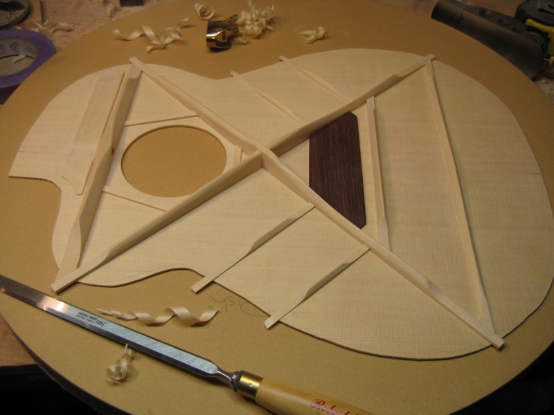

Here is shot of the top I did, it is ventian but the principle should be the same for a florentine. The x braces and the the braces that touch them at the ends are notched into the linings and the others fall short. I actually trimmed the fnger braces to nothing before they reached the linings. I hope this picture will help out a bit!

Shane, my cutaway is much deeper than yours & the issue is I can't put the utb across straight without it passing through the soundhole area.
I don't use a graft like yours anymore... I use an extension on the top portion of the heel block instead.
For this guit, i will have to trim some of the extension away & put the brace in at an angle. (or something else more creative... Not completely decided yet.)

Sweet looking top Shane! Very neat, clean, and "Lance-ish"!
